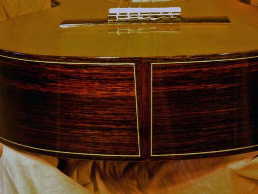

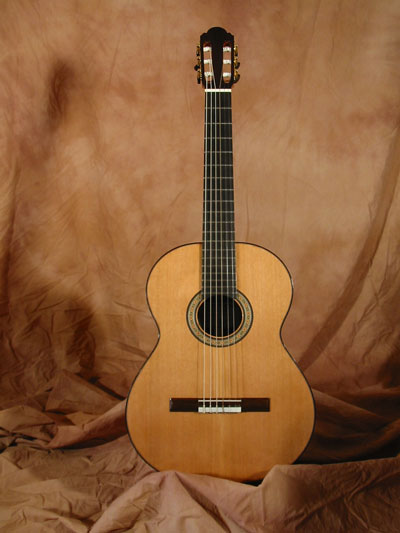

I thought I'd try my hand at a classical instrument instead of my usual steel string type. As I try to build most of my steel strings for finger style playing, an occasional dred slips in now and then, but I thought it might help me in my steel string building as well.
The run down:
EIR back and sides
Western red cedar top
built following the Fleta plan pretty doggone close
EIR binding with a white and green side purfling. The green looks nice when you can see it but the dark rosewood hides it pretty well in the pictures.
The sound is very even with a strong bass and good clear sustaining trebels.

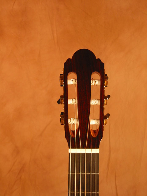

Very nice! I really like the headstock shape.

Nice work, Jim. I like the headstock. Is that Fleta's design or yours?

Ken, this is very close to Fleta's head stock, he had 2 extra cuts on each side. It didn't seem right exactly copying his head stock so I left out a little detail that would make it much nicer actually.

I too really like the headstock lines.

BTW, when you string it up, if you wind the string in the direction of the tuners instead toward the middle of your slots, there will be less chance of damaging the finish from your strings rubbing the inside of the headstock slots. Don't ask me how I know that.
